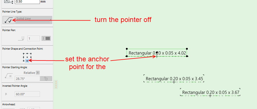

If you have the leader line on, you will always just get a default leader line.
If you turn it off, you can control the position of the label a bit with the anchor point.

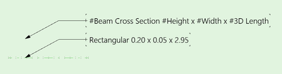

You can add a label.
An autotext label is probably the best, as you can format it to say exactly what you want.
vikass
Can you please elaborate? Adding beam cross section in autotext label doesnt show the beam X x Y.
Beam cross section is whether it is rectangular or round.
You want just 'width' & 'height' from the general parameters.
vikass
Yes. Thanks

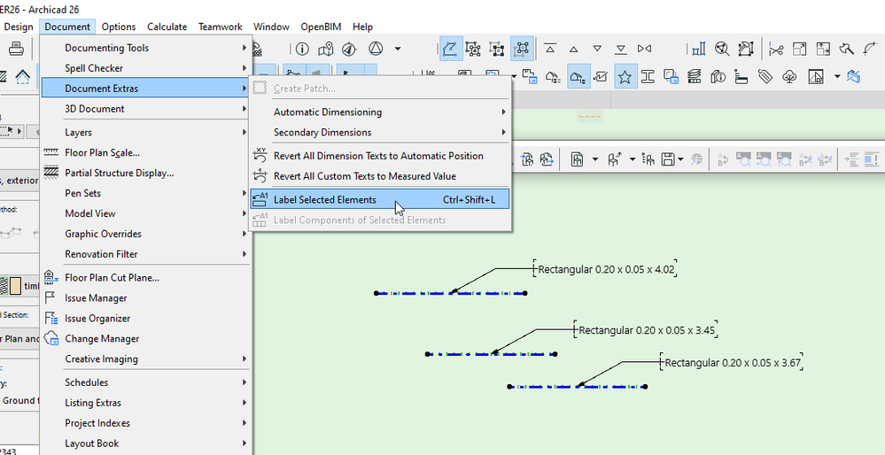

Additionally, is it possible to add autotext labels to all the beams at once in a floor plan?
Xandros
As soon as you're done setting up one label, you can ALT + leftclick it to define it as your standard setting for upcoming labels.
Afterwards you can select all your beams at once with the beam-tool active plus CTRL + A or via Search and Select (CTRL + Shift + A).
Then use the label selected elements tool, which you can find here:
Document > Annotation > Label Selected Elements
https://help.graphisoft.com/AC/26/INT/index.htm#t=_AC26_Help%2F070_Documentation%2F070_Documentation...
https://help.graphisoft.com/AC/26/INT/index.htm#t=_AC26_Help%2F030_Interaction%2F030_Interaction-98....
https://help.graphisoft.com/AC/26/INT/index.htm#t=_AC26_Help%2F030_Interaction%2F030_Interaction-28....

Sure.
The label will associate to the centre of the beam.
