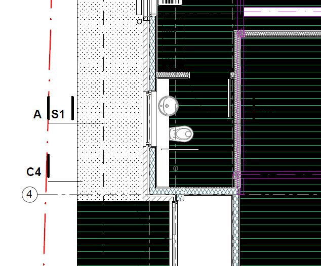

If the reference is set to display with a 'uniform colour', it prints ok. If the reference is set to 'original colour', any slabs on the reference print with their coverfill displaying
This seems quite repeatable for me on different files and in both AC11 and 12.
Hopefully it may be that I have set something accidently, as I could have sworn this worked ok before!
The reason for me doing this (not that it matters. It should work as expected) was to quickly overlay some first floor beams onto the ground floor plan. The first floor plan needs to be the active drawing to display on top of the reference; otherwise various fills obscure the beams, and the reference needs to be the original colour to show the detail correctly. (and yes, I know I can create a layout and overlay the two manually, but this was meant to be a quick temporary print
Many thanks!

Peter wrote:Yes, I can confirm this bug in both AC11 and AC12, with one observation: in AC12, even if the reference is set to "uniform color" and the slabs' cover fills are turned off, the printed result shows a semitransparent fill over the slabs, with the same color hue as the rest of the reference.
Can anyone else confirm a bug when printing from the floorplan with a reference displayed?

Thanks Adrian!
Can someone report this bug to the appropriate people please!

I have reported it to Graphisoft.
