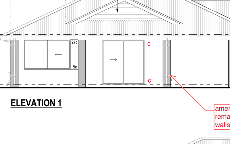

I need help with a couple of things. First, I need to display the C coursing chart in elevation views, specifically showing the window height. I'm not sure where to find that setting.

I mean, how do I turn on the coursing chart height from the settings to display it in elevation view like this?

You need either an object or a label that can show the heights in brick courses.
I see you have an Aussie e-mail address, so you may have access to the Central Innovation library?
I am not familiar with it or the default Graphisoft library, so I am not sure if there is anything in there that can show course heights.
I have my own library and course height object that unfortunately I can not share.
