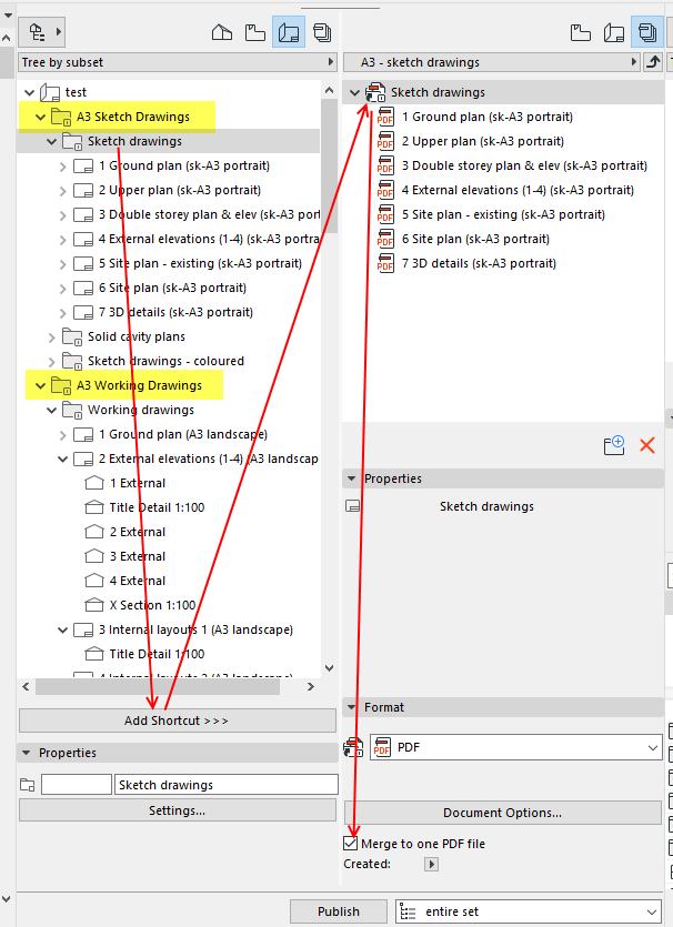

I am not sure I understand your issue.
You can only have one layout book per file, but you can have as many folders in that layout book as you need.
I have folders for sketch plans and construction plans, even for different page size layouts.
Then I set up publisher sets that publish only the layout folders that I want.
I create 'shortcuts' so if there is a change to the layouts, the publisher updates automatically.
I merger the publisher set so it creates a single PDF with all of the pages.
