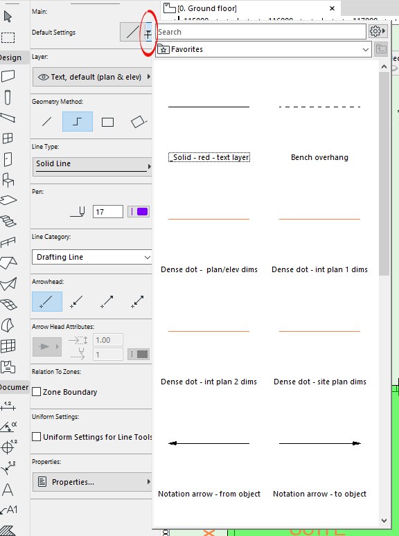

It is not hard to change the pen colour of a line, but if you really need to, you can save line favourites for each pen colour (thickness) that you want.
Then just activate the favourite and the colour/thickness will be set - as well as the line style, arrow ends and other settings.
My image shows "Solid - red -text layer" but shows a black line.
That is because I changed my pen set colour and have not updated the favourites.

And, to add to Barry's example of using Favorites so that you can set up the line/colors that you want... you can quickly switch the line tool to use any visible line (type and color) by using the eyedropper tool.
Update:  To clarify, using the eyedropper tool switches the active tool to whatever you've clicked on... with all of the settings of that element.  So doing an eyedropper on a line will activate the line tool to draw more of that style line.  Doing it to a Wall will activate the wall tool, ready to model more walls with identical settings.  Etc.
Karl Ottenstein
Moderator Emeritus

Ok will test that tomorrow as well this would be life changing because I constantly change lines and colors although they are all coupled same (dotted has certain color and straight has certain colors). Didn’t know about favorites so hopefully it’s accessible . Thanks and will give update ☺️

ok I tested this and it Is sufficient! thanks
