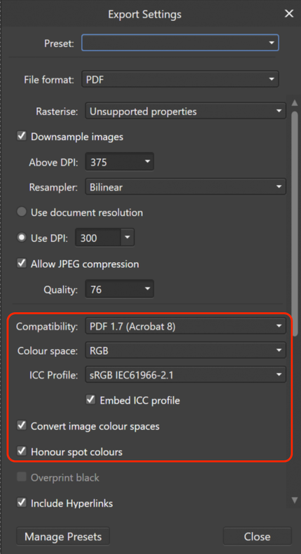

JPEG images use the sRGB color space.  When viewing on-screen, you are seeing the current Mac display color profile's interpretation of those colors.  When the PDF is created, the color space for the embedded image could be changed to RGB or Adobe RGB etc....and when viewing... even if the RBG color codes are identical, the PDF viewer could be using a different color profile to interpret that color space.  For example, InDesign let's you look at colors with the monitor's color profile, or the printer profile for a particular paper.
What I could not see, and why my post is really not helpful, is any way on the Mac to select the color space or the color profile for a PDF.  Certainly using File > Print from a Layout and then the Save as PDF option has no color options.  And, using Publisher to publish to PDF... those PDF settings also don't have settings for embedded color space or embedded color profile.  It's very interesting that it works properly on Windows, but it seems it would take some detective work to figure out why this is happening on Mac... but without any settings options for creating the PDF, it would only be academic to figure out why its happening.  Unless of course it is something Graphisoft can fix.
AC 28 USA and earlier   •   macOS Sequoia 15.4, MacBook Pro M2 Max 12CPU/30GPU cores, 32GB
I Googled a bit and found these PDF export settings for Affinity Publisher which do indeed let you choose the color space and profile for the exported PDF there.   I wonder if that's something we should be adding to the Archicad wishlist...other than you said everything works fine on Windows without these extra settings...
