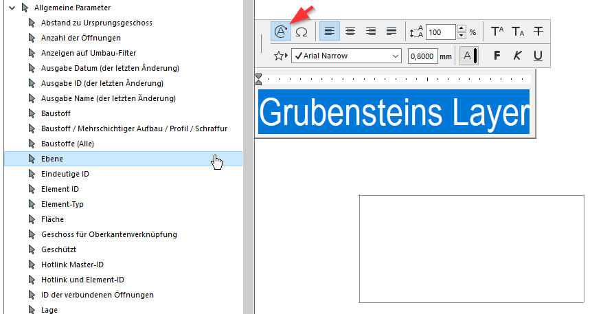

I have a lot of fills so just want to click on the fill and tag the layer name. So dont mind setting it up if thats whats needed
Stefan L_
Rockstar
Use the Text/Autotext label, then click on the marked button and select the appropriate entry:
Stefan
AC ...-29, WIN10
Brilliant thank you sir!
