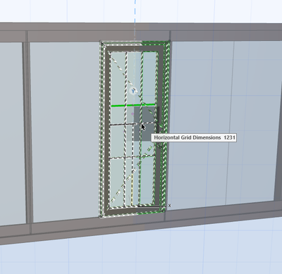

Hello all,
I'm trying to use the CW Door Sliding 26, with a Leaf that has an "Editable Grid" in a curtain wall panel.
Everything looks good until I try to edit the grid in the Leaf. My edits are not committed by the software.
Please refer to the attached video. Does anyone have any idea what I might be doing wrong here?
Bonus Round:
I decided to try another avenue: make a custom door leaf. At the end of the attached video, I execute the Convert Selection To Morph(s) command. The operation does not retain the apparent level detail in the resultant morph. It also changes the position of the Opening Line. Bonus points for any ideas about what might be going on here!

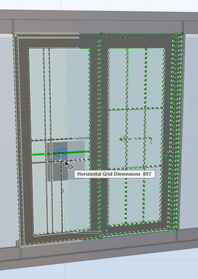

Having no issue with it in AC22 AUS 7000, or AC27 INT TP 2000 / 2021 on Win10. Which OS are you using?
Hiya,
I'm using AC26 3001 NZE on Windows 10.
Thank you for your comment, you've prompted me to try the operation on:
AC25 4013 NZE (does not work)
AC23 3003 INT (works! Including the Bonus Round)
I tried copying and pasting a successfully edited Leaf from AC23 into AC25 / AC26. Any edits I had made to the custom Leaf copied over successfully, but subsequent manipulations remained dysfunctional.

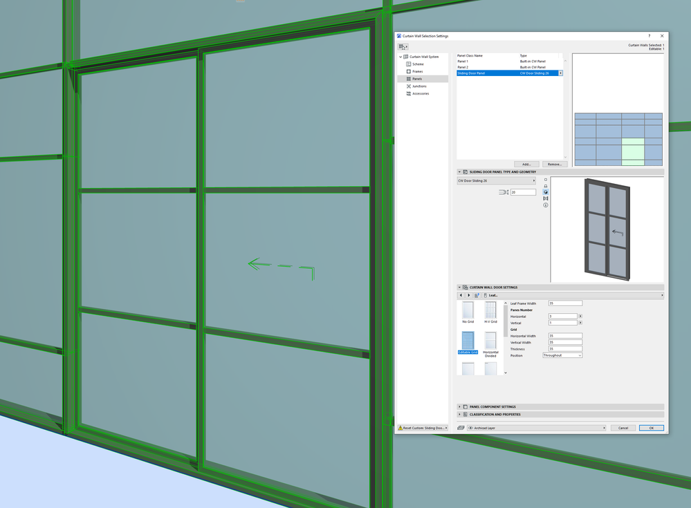

So are you saying that you have the 26 library loaded.
You place a curtain wall and change a panel to "CW Door 26".
You choose the "Editable Grid" option for that panel.
But you do not have the editable hotspots to adjust the grid?
I also tried it with the "CW Door Sliding 26" as well and it works for me.
Do you have just the 26 library loaded?
Is this a newly placed curtain wall or one that has come from an old plan from an old version?
