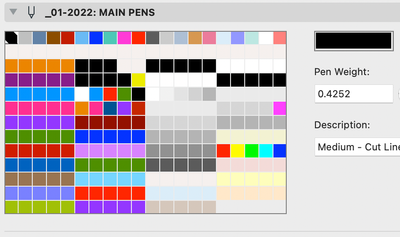

Hello.
I need to develop custom pen sets and I would like to start a conversation regarding pen sets in general, and also the logic behind creating custom pen sets that meet custom design standards.
Any hints / tips / ideas would be appreciated.
First of all, let us agree that the predefined pen sets have a very specific structure that not always is compatible with the design standards of an architectural practice.
Therefore, there comes the need to adjust the pen sets to the custom needs by:
A) keeping the logic of the predefined ones and making the necessary adjustments regarding colours, line weights etc + adding custom pens in the empty spots to meet more specific needs, or
B) creating a totally new pen set logic.
I believe there is no “right” answer in this. But let’s assume that the option B is the one we choose now, for many reasons.
In this case, the Archicad logic with elements that use specific pens does not apply anymore, so there comes the need to save Favourites that are adjusted to the new pen set logic.
What else should be taken into account in this case? Do you people have a specific structure that has been efficient?
Thank you in advance.

As you stated, there are many approaches.  I would consider the modeling and document type emphasis of your firm, your work flow and collaboration with others, and consideration of the opportunity to employ GORs and/or multiple pen sets.  For example, a lot of my work centers around planning and feasibility with several disciplines at once, so my approach may be very different from others.  In my modeling environment, I particularly wanted to have some level of engineering systems breakout without needing a lot of different pen sets. On the other hand, I have less need for technical rendering visualization. (For the latter, I typically use BIMx.)
With the above, I considered the following:
  • How can I quickly differentiate different discipline and element types in the AC 2D modeling windows?
  • Can I avoid changing pens on default AC object pen assignments?
  • How can I simply address 2D imports (e.g., DWGs), which I routinely receive but want to simplify on-screen?
  • How do I easily address scale?
  • How do I allow for black and gray scale capability?
With that, I set up a main pen set which I use for most views.
  • I noted most AC objects OOTB mostly use the first row of pens [1-20], along with pen 91 (white), so I kept these as-is.
  • On the second row [21-40] I placed black and gray scales.
  • Under these rows I placed twenty blocks of color groups and weights to represent various disciplines and system types, etc.
  • The bottom left row [241-249] I placed a set of ten 'typical' ACAD colors (basically AC 18 default 121-129 plus white), which I use for certain DWG imports and reference lines.  These I may use on worksheets and the like. Next to this [251-253] I kept three AC 18 standard RGB color pens.
  • I set aside a block of 20 unassigned pens for project specific visualization or other uses.
Then, with this main set in place, I created a few scaled (weight changed) version pen sets.  When I need to change color schemes, I utilize GORs.  I could also set up alternate color pen sets, and I imagine there may be ways to use less pens and rely more on GORs, but this setup works fairly well for my projects these past several years.
