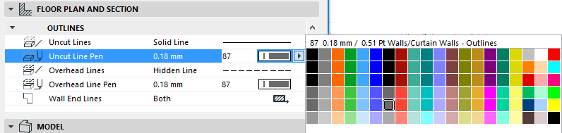

In this case, the Archicad logic with elements that use specific pens does not apply anymore, so there comes the need to save Favourites that are adjusted to the new pen set logic.

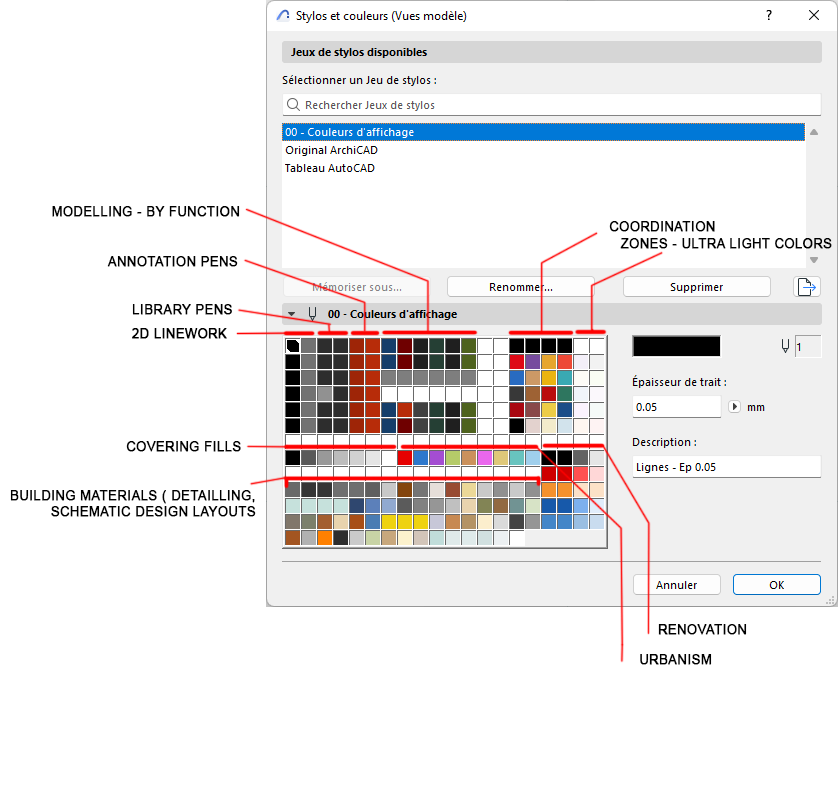

I have a main penset, it's based on elements function
  • Structural
  • Non-structural
  • Finishes
  • Stairs and railings
  • Terrain
Each category have 3 pens : cut, uncut, overhead
These pens are from column 5 to 9
This way, i have control on all cut elements pen thickness at once
  • The pens used by library parts are UNTOUCHED,column 3 and 4
  • Mep have pens by function : clean air, dirty water, hot water, gaz, wiring etc
  • + one pen for each category : purple for plumbing work, rose for ventilation work, theese pens are used with graphic overrides : 1 pen to show a system
  • Building materials have pens by category, brickwork, concrete, insulation,
  • Covering pens : for coverfills pattern , light colors
Almost all my pens are thin, even the cut pens, beacause thick pens hide some details in plans, i use solid dark fills for thin finish fills in plan so they look like cut thick pens
I'll share my pensets once i get in my office

If you are using the default library objects, then you will want to study them and find out what default pens they use for lines and fills.
You will probably want to keep those pens as standard in your custom pen sets.
At least keep the same line weight even if you change the colour.
Otherwise you will need to create favourites of every object so you do not have to manually swap pens to suit your custom setup.
I also recommend keeping any white pens from the default pen sets as white in your custom pen sets as these are used as the solid hatch and/or background fill pen colour so they do not print.

Pen 19 and 91 should stay white to avoid unnecessary object editing.
Keep pens 1-20 as is but change their line weight to the thinnest one so that they always show in color when an user forgets to edit the object they just imported but the line weight doesn't screw up the drawings.
In my case I have a set of Black Pens and White (5) assigned by 2d representation. Graphic (Door swings etc) - Overhead - UnCut - Cut (Small thickness) - Cut
Then a set of 5 very thick pens based on technical pens.
Colors are for GOs.
I have to clean up this set since it has been edited since AC08
