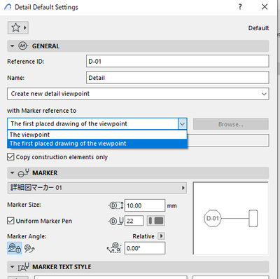

Hi All,
I am trying to make the detail marker show the layout the view is placed on. I can manually draw write the layout ID in there, but if I add more sheets or change the order of the sheets, I would like this to automatically update.
I know this must be possible as there is a checkbox there, but I cant make it turn on.

Set "with Marker reference to" to "The first placed drawing  of the viewpoint".

Thank you very much.
