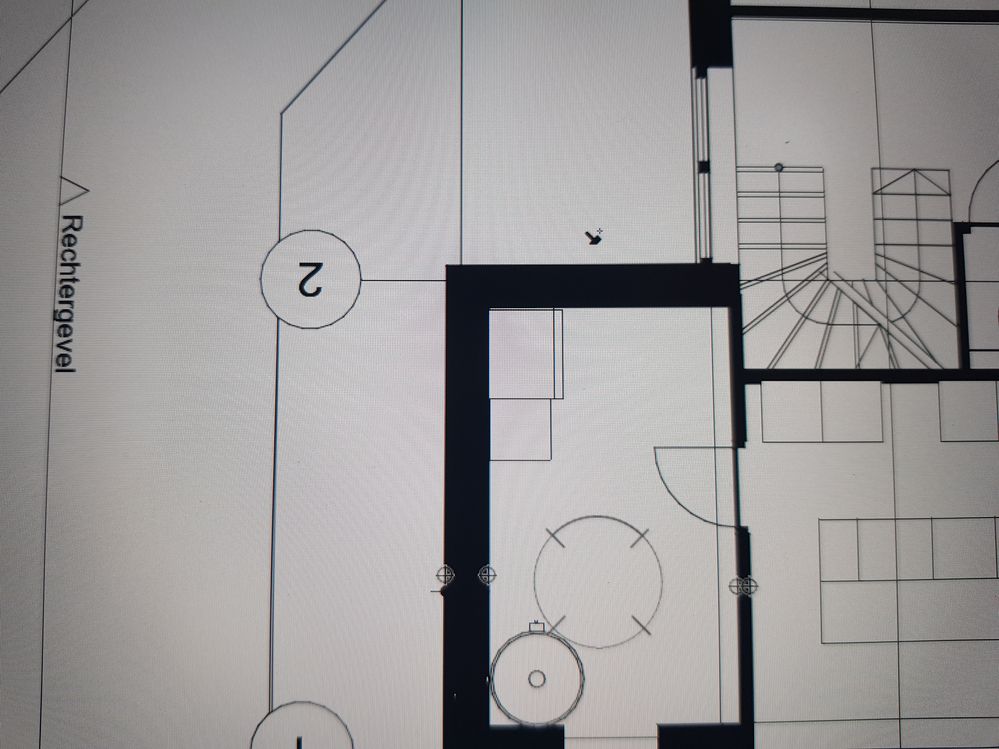

i've got the same problem. for me the grid thing is off and i selected xy. but it is still not working for me. anyone an idea?
So you have the linear dimension tool active?
You click what you want to dimension and you see little circles?
You then double click to finish selecting points and then you place the dimension line?
Where is the process failing?
xxr
I can click on the walls i need. i also get the littel hammer. i just dont get a line i can drag to the right position. The crazyest part is, that evertying in the map goes right exept for one specific piece. I upload a picture maybe that clears my problem.
