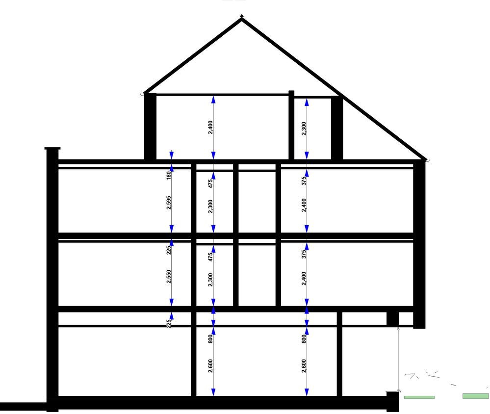

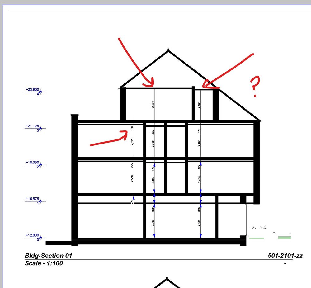

Hello AC community,
We have created a very simple section through a building.
The saved model view (image can be seen below) we have included a string dimension for the floors / ceilings etc. When placing the view on the layout the dimension arrows aren't appearing correctly and on some sections disappear altogether.
Has anyone seen this bug or have any suggestions / work around to get the arrows & dimensions appearing correctly.
Many thanks for reading.
Chris S

Section dimesnion markers view in model.jpgSection dimesnion markers view saved on layout.jpg

Hi Noemi,
I think it is a different topic... we have had a solution for our particular query thankfully.
Arrow size was the problem as described in the article below.

Thanks for the reply Noemi really appreciated.
I have tried runnning through the options on th article with no joy i'm afraid. There is another article linked below which suggests there is a known bug which the developers are aware off the issue.
https://community.graphisoft.com/t5/Collaborate-forum/Archicad-25-Teamwork-migration-dimension-bug-o...
I have contacted Graphisoft support as it is a big problem for us.
