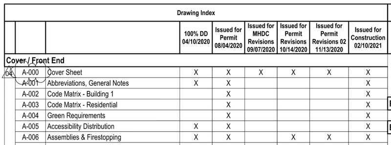

Drawing Index: Fine for layout book but what about publish set?
So much great work done over the years for publising'
Im just wondering how the project drawing index can accurately present published outputs as they are often reassembly of a master list?
Or at least have context sensitivity so that if they arent on this publish set, they are hidden in list

It may not be automated, but one way to filter a drawing sheet index is to create a new parameter in your book settings, under Layout Info Scheme. Your sheet index schedule could then be set to show only sheets with an "X" under the created parameter, for example. You could therefore have multiple scheme settings created for each publisher set or, alternatively, you could have a sheet index that shows all issuances and displays an "X" for applicable issuances. Similar to the screenshot below.
