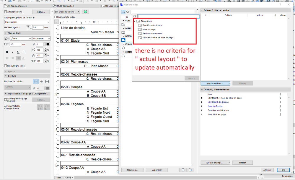

is there any way to create such a list please ??

yes i just looked for it and tweaked parameters,
but i have to create tens of lists, each list for specified drawing placed on specified layout
it cannot be placed on master layout so it updates automatically

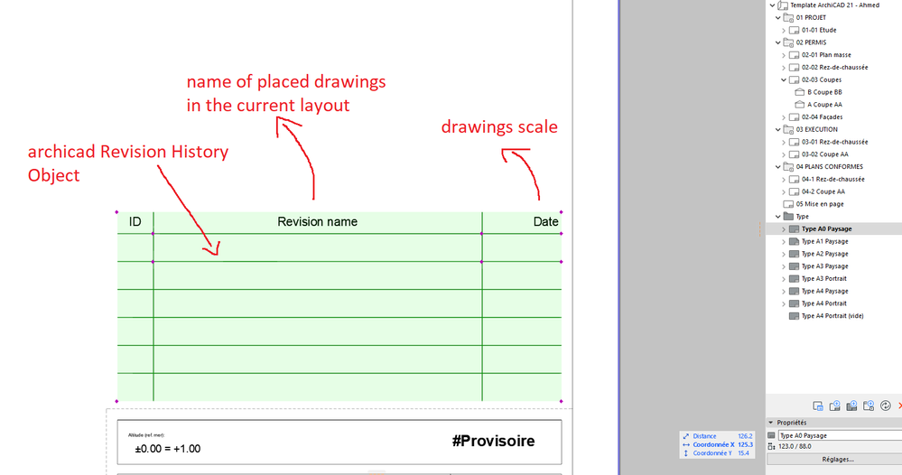

another possibility :
is it possible to change the default Revision History Object to receive thoose parameters shown in the attachment, ?? needs scripting skills maybe

It is possible to list all drawings placed on a layout by using Auto Text, but the text is returned as a series of comma-separated values
eg. If I draw a text box on a layout (or master layout) and insert Auto Text from the 'Drawing' sub-menu (see screen shot)
To achieve anything better than this (like a table) would involve a GDL scripted object.
What is the purpose of such a list, if all the drawings are placed on the layout anyway?
