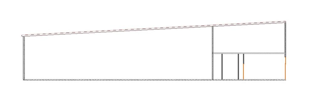

I am having an issue with elements not showing in section view. All the solutions provided in posts I have see don't seem to fix the issue.
I have checked:
Renovation filters
Layer combinations
Any ideas?

Its a number of elements - Columns, stairs, plumbing fittings, some exterior walls
I have checked the model views and they seem ok.
Please see attached the floor plan and the section incase they help in any way.

Have you tried turning all layers on to visible. I know you mentioned you had checked layer combinations but it would be worth a try. It would be useful to post some screenshots of the section, the section settings and a 3D view to see if the elements appear there.

Is the section set to zero depth in the section settings? If it is try setting it to infinite or set depth.

Any chance you'd be willing to share the model? It does look like a zero depth section. You may be right Lee.
