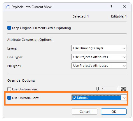

I’m not sure if this will solve it, but have you tried selecting “Use Uniform Font” under Override Options?

Thank you for the suggestion, but no, the "Use Uniform Font" option does not remedy the issue. I believe it has to do with Archicad simply not recognizing the font in the pdf.
