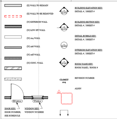

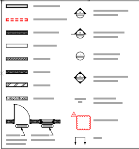

I have a client who has font's showing incorrectly from one computer to another. The font itself does not appear to be missing, but the kerning/spacing/etc. of the text from one computer to another is messed up.
In the attached screen shots from two users on the same file; one shows the font lining up correctly. The other shows the fonts compacted and misaligned with the drafted legend elements. Both are joining to the same t/w file. Both have the fonts loaded on their computers, both are showing with the correct font name, not including brakets [-----] that would indicate the font file is missing or loading incorrectly.
Are there any tricks to getting a font to read consistently from Mac to PC?

Font showing incorrect spacing/alignment
Font showing correct spacing/alignment (screen grab at lower resolution):

The problem lies with how MAC and Windows interpret font size/spacing. This will happen with any font, as far as I know and isn't exclusive to ArchiCAD. You will have the same issues with something like Excel rows fitting the page and whatnot.
We used to have a few macbook pro machines that we mostly just used for client presentation, but if you actually worked on a project there, we would also have issues with font spacing and we use 'standard' Arial.

From what I recall it has to do with mac using 72 ppi and windows using 96 ppi when translating font sizes.

another thought is that while they share the same font names, the Windows and Mac versions of these fonts do not share the same header. We experienced this with Futura and had to hack the header of the Windows version to achieve parity and predictable results.
