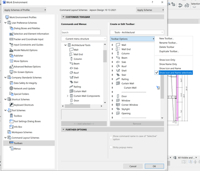

2021-12-27 01:37 AM - edited 2021-12-27 01:39 AM
Could be Toolbar Options ?

2021-12-27 02:44 AM
Thank you Steve, I've played around with the toolbar icon options but no luck yet!
2021-12-27 11:37 AM
I you make de toolbox smaller just by dragging it on the edge. The text will dissappear and -according to the witdh- the icons appear in one or two colums
