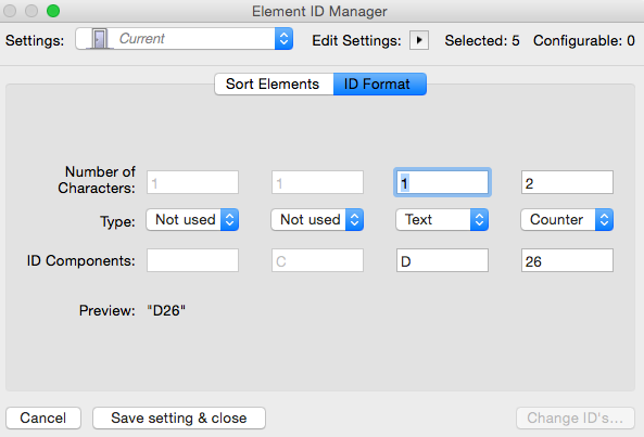

Hi, I have created a hot linked module of a toilet block that I have repeated. I now find that I cannot do automatic numbering through, document, element ID manager, because change ID is not available. Any advice appreciated. Cheers Scotty

I think you'll find you answer here:
http://helpcenter.graphisoft.com/guides/archicad-18-int-reference-guide/user-interface-reference/dia...
Under 'Master ID' it says:
As a result, all elements have unique IDs, yet for Hotlinked Module elements, their IDs remain protected from editing in ID Manager.

Thanks, but this doesn't actually describe how to do id door numbering, and labelling elements is still not available, but it does seem like it is saying that if its a hotline that you cannot edit the ID. It would appear that the only way to edit individual element ID is to break the hotlink?

Yes, it seems that the only way to edit the ID is to break the hotlink when you're using a hot linked module.

Or, open the Hotlinked Module file and do your numbering there. Then, with differente Master IDs for each placed Hotlinked Module instance the IDs will be unique for each element.

But how do you set multiple Master ID's for multiple hotlinked modules?
As I see it now, you can only set one Master ID for all hotlinked modules.

You can select any placed instance of a Hotlinked Module, right-click and select the Hotlinked Module Settings command, and then set the Master ID for that Hotlinked Module in the upcoming Dialog.
