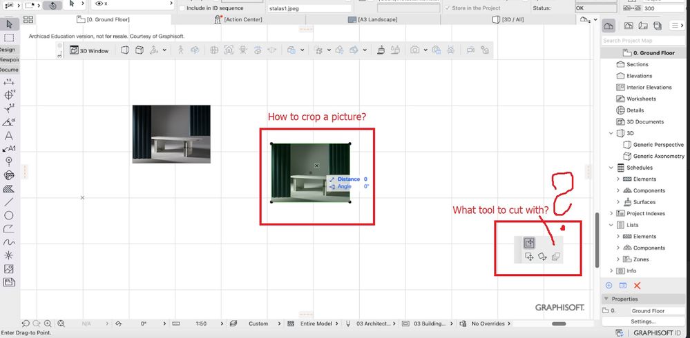

Place the image with the drawing tool instead.
2023-01-12 01:11 PM
2023-01-13 02:27 AM
Can you crop image in Archicad? What I usually do is create a fill with a solid background that would hide the other parts of the image I don't want to show.
2024-01-24 11:58 AM
Thank you, Erwin. You are really Rockstar!
I`d never thought to insert jpg with drawing tool. It works perfectly.
