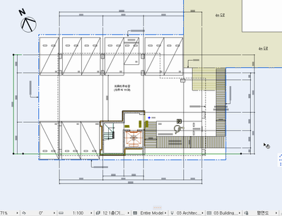

In the architecture plan, copy the dimensions and lines with CTRL+C, go to the structure plan, copy them to another place, change the line layer, and move them back to the origin.
Is the way I'm doing it right? Something is strange, so I ask.

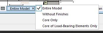

so it looks like you've moved from "Entire Model" to "Core Only" in the Partial Structure Display (PSD).
unfortunately, you can't copy dimensions from one PSD to another AND keep the dimensions linked to whatever element they were dimensioning. you either do the dimensioning twice for each PSD, or like what you've done, copy from Entire Model into Core Only & re-link the dimensions.
If you don't re-link the dimensions, these will remain Static Dimensions & that's a really bad thing to have in a Structural plan.

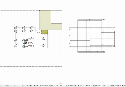

When you say "Structure Plan" what do you mean? Is it another View? Does it have a different Layer Combination? Or is the Partial Structure Combination option switched from "Entire Model" to "Core Only"?
Could you show some screenshots about what is strange? What is the exact issue that is not working for you as expected?

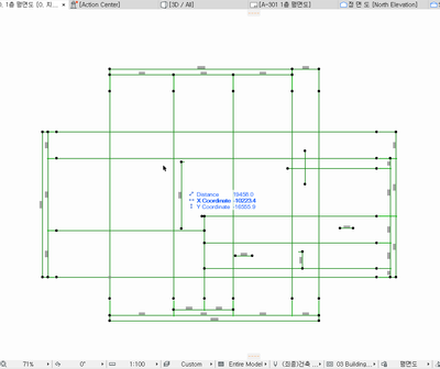

LeeJaeYoung_1-1665890142202.pngLeeJaeYoung_2-1665890168528.pngLeeJaeYoung_3-1665890235638.png
The reason I move to the side is to change the layer of the whole line like dimension.
Change the layer to S-CenterLine and bring it back in place.
I think I may have misunderstood something because I am studying on my own.

Just put on the Archicad Layer on the spot, change the layer and come back. I was doing this because I thought it would be difficult to select due to other lines and existing layers, but I was doing something stupid. ^^ Thanks for your interest.
