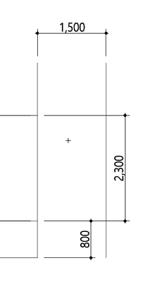

I want the dimension to be at 1500mm. But what should I do?
LeeJaeYoung

Solution
Double click to get the hammer.
Move the cursor to the point you want to measure the 1500 from.
Type X or Y (for horizontal/vertical - X for your image above) and then 1500 +/- (depending on the direction you want to go and then ENTER.
Solution
Yes, double click to bring up the hammer icon.
Hover the mouse over the point (line) where you want to measure from.
Type X1500+
ENTER.
See attached video.
