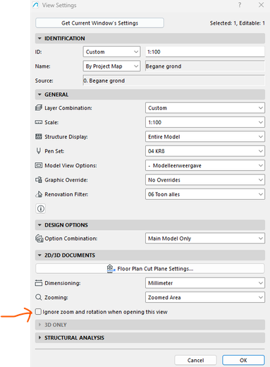

If I understand correctly the rotation of the view is not correct on your layout? Have you checked the zoom/rotation checkbox on your views (see arrow on printscreen)? With this you can save a specific zoom or rotation on your view.
Hope it helps,
(regarding your workflow; I have found that updating drawings from multiple external files could take quite a while depending on project size, something to think about on larger projects)
