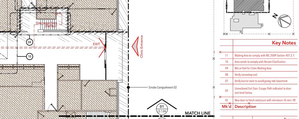

Ok, the keynotes in ArchiCAD are killing me. Having just come over from the Revit world, this is very frustrating so I'm reaching out to see how you guys handle this. This is what I did:
1. Created Section 1. Used Label tool to create Keynotes (just a number with a frame). Keynote 1, Keynote 2, etc. I created like 10 Keynotes.
2. Created Section 2. Created Keynotes 1, 2, 3, 4, and so on. Like 8 Keynotes.
3. Created Section 3. Created Keynotes, 1, 2, 3, and 4
Now, I put all three sections on one layout. Now it was time to type out all the keynotes in a keynote box for the sheet (excuse me, layout).
That's when it hit me. Each Section has a keynote 1, and a Keynote 2.
What am I supposed to do, go back to Section 2 and start with 11, 12, and 13 (where Section 1 left off?)
That can't be right?
How do you guys and gals deal with this?

Well, the truth is that by default ARCHICAD does not have a Keynote feature that would provide the same functionality as the Revit Keynote feature. So these will just be workarounds.
Currently the CadImage Keynote Add-On (not free) provides keynoting functionality.
We hope that soon ARCHICAD will incorporate this needed functionality natively.

These are my 2 workarounds:
1.For simple projects use "JS Shape Tag" Object or the "Multileader Label" placed in an unused Floor Plan with Property Text added. You can define the KN Number and Text and then create a schedule for the legend. This is a "non-intellignet" procedure were you keep adding objects as keynotes are needed. The KN would be placed in the ID field for the object and the description in a text field that is added in the schedule or in a Custom Property for the object.
2. Option 2 is to create AC Properties for the project for Keynote Number and Description and use Labels to pull the number from the object. This is more intelligent (and ideal) because the property is attached to the object, the surface or the Building Material. With this option you could export to Excel and link the properties to those fields which can make life easier for adding the keynote text.
As an experiment you could try to use Change Manager as a Keynote Manager. I have done this for simple projects were I know that I will not use CM to manage changes (Life Safety Documentation). This has the benefit that the "Keynote Legend" can be configured to only list the changes in that particular sheet
