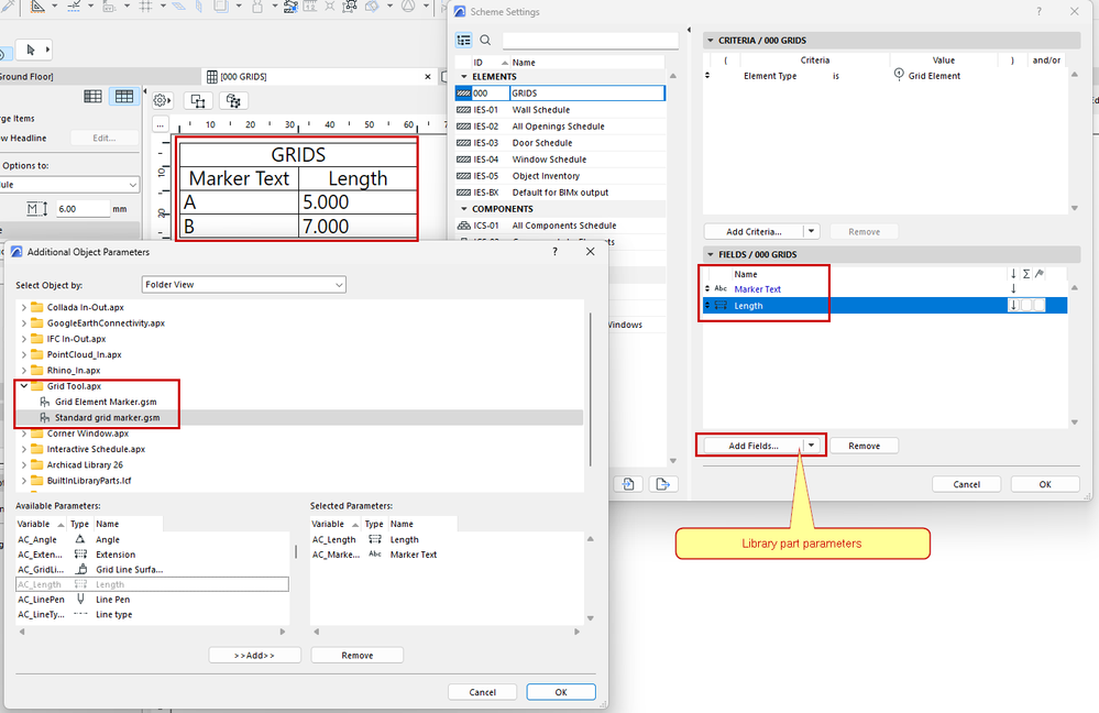

Is there a label that can pick up the length of a gridline?

I am not sure if a label can be directly used for that, but you can create a Schedule using the library part parameters from the gsm grid object, as seen on attatched image.
(Maybe editing the GDL object could be another way to solve it...)
