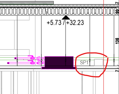

Does anyone know why labels in section are not properly converted in dwg?
Picture shows how the text is outside of the box.
My floorplan is good and I didn't check the box convert archicad labels to leaders in my translator
Archicad 25, build 4013

There is one Save option in the DWG Translator Dialog which may influences this.
Please try to turn ON or OFF the "Convert Labels to leaders" option, see it one of the two states solves this problem.

Yes , i know about this and purposely keep it unchecked.
It seems this happens only to composite label. When I use autotext with automatic text it is all good. I believe there is a bug in script of the composite label.

OK, I will forward this to GS HQ.
