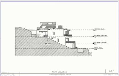

2023-06-27 11:00 PM
The text in the master is black but it shows as red in the Layout Book & Publisher set.
Any idea on how to correct this issue?

2023-06-28 03:31 AM - edited 2023-06-28 03:32 AM
It is a Work Environment setting.
Simply so you can tell what is on the master layout as opposed to the layout itself.
It will all print in its correct colours.

2023-06-28 02:53 PM - edited 2023-06-28 02:53 PM
It worked! Thank you, Barry!
