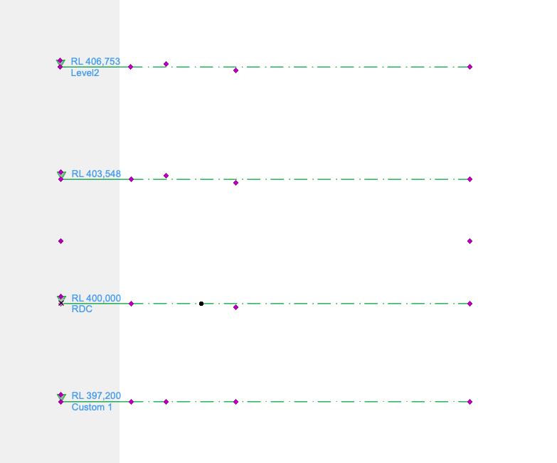

I took the liberty of doing a test by moving the points that change the height and hide the level.
I find that there are too many points on the story line, so I moved them slightly above and below the story.

The storey height hotspot needs to be on the line in case you want to snap it to something. Could offset the toggle ones. I only have access to ac22 and 23 so I am unsure what else you might have changed. Hide the level? Could put a toggle to for each type of hotspot, which I have done on other objects.
I saved it in archicad 23.
The storey height hotspot is offset before initiating the modification , but when you click on it, the height modification is not shifted.

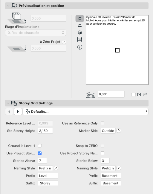

Hi!
I have a bug using the "use project storey" option

The arrays sometimes do not refresh when toggling that option, as well as the reference only option... You can get around this by adding then removing additional storeys.
ps. Are you using display scaling? The text descriptions should not be cropping...
