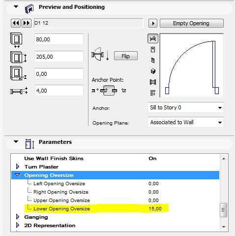

...but it looks that its not possible to have a wallhole bigger (extended below) the door unit. or is it ?
Yes it is possible. Use Door parameter "Lower Opening Oversize" to increase the door wallhole.
That is so true Andro ! thank you ... I know that it was there in old days , and looked for it ... but I was just looking in the easy - new- graphical interface way .. not the old good Parameters tab, and that is why I didn't find it ! Thanx again Andro.
