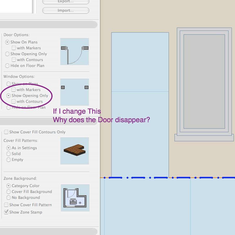

Is this a BUG? or am I missing something.
PS. Of course I find this when I miss a deadline because my doors and windows were disappearing.

Image 02:
Turning the Window Off

TomWaltz
You're not a beta tester if you don't have a way to directly report bugs 😉
Are you rebuilding the elevation before or after the screenshots?

Eduardo Rolon
Before the screenshot

henrypootel
Graphisoft Partner
Graphisoft Partner
I can confirm this on build 1033 NZE.
I think someone at GS had their wires crossed.

Eduardo Rolon
Fixed on the 1086 build.

Thomas Holm
It's the underlying logic: Windows are really Doors with a high threshold... or is it the other way around?
