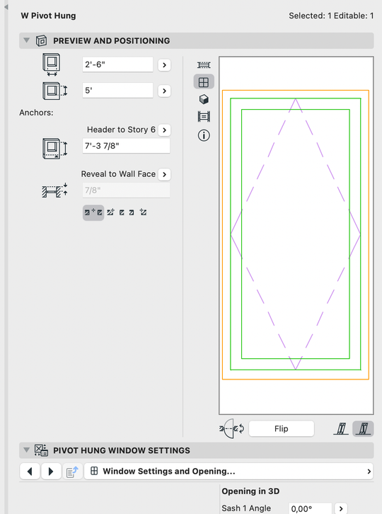

Furthermore: the same problem with the USA dedicated object, W Pivot Hung. Same diamond shape instead of an X, no matter what I set the line orientation in the USA MVO settings. (BTW, it would be great to have the same MVO panel for USA and INT windows, I see no reason for the double settings.)

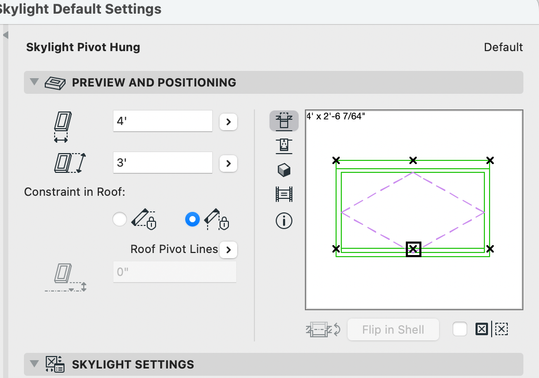

Even further more: Seems to be the same problem with Skylights!
