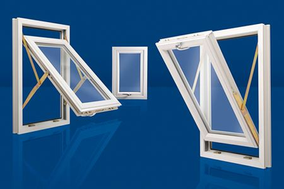

I don't think that is a reversible window. They are more like this:
Besides the point, but the terminology is a bit hazy when it gets to Archicad. What Graphisoft offers are center pivot windows (horizontal or vertical). But I think it is OK to use them for reversible as well since their mechanics are complicated and a center-pivot is a simple way to symbolize them.
