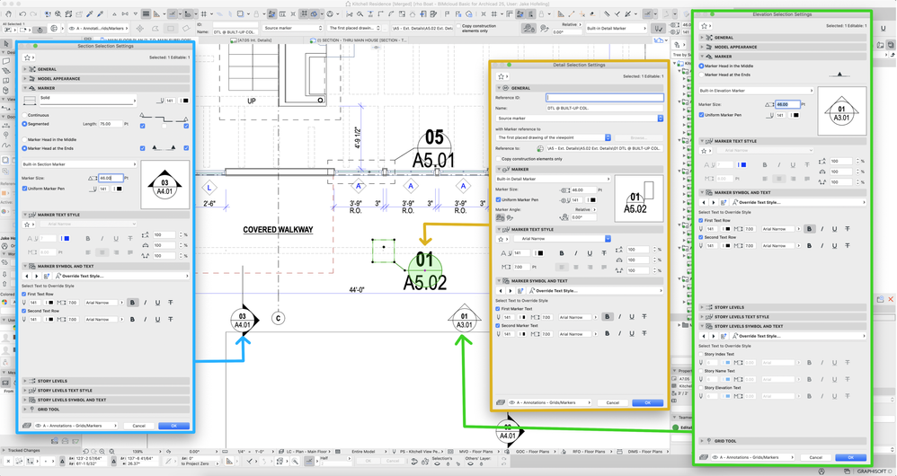

Hi there, I cannot get the detail marker to match the size or font of the elevation/section markers.
I've checked all the settings and they appear to share the same values. Any thoughts how this could be happening?

The circle being larger than your section one is because the detail marker measurement is taken as the diameter of the circle, whereas the section marker measurement is point to point of the arrow rather than the circle diameter. You might find they match better if you make the detail marker diameter at around 30pt?
As for the text size, that's weird, not sure why it's doing that?
