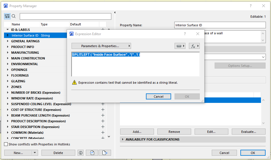

I've been trying to do the same with expressions using the splitting rule for surface names, examples below...
Surface Name Example - WB | Weatherboard
Expression Example - SPLITLEFT ( "{Property:Wall/Inside Face Surface}" , "|" , 1 )
However the expression editor won't recognise this & comes up with the following message "expression contains text that cannot be identified as a string literal". Have attached a screenshot of the error & setup.
Any ideas what I'm doing wrong?
JeffH
It works for me if I remove the " _ " quote marks before and after the defined parameter.

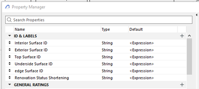

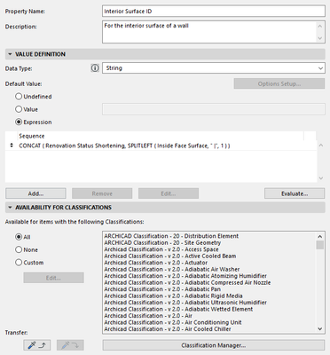

I solved the issue by doing what @JeffH replied with & these work in all views (plan, section, elevation...). I have the following property expressions made which can then be used as autotext in our labels (have these labels also saved as favourites)...
All expressions are pretty much identical (see screenshot below), only difference being what surface is being called out. Basically what its saying is to only show the letters to the left of the '|' symbol. For our surfaces we have a naming convention (Code | Surface Name & Description). As an example TF1 | 90mm Timber Flooring will show up as TF1  when using one of these tags.
Have added an extra expression which is automatically showing the renovation status of the finish as a prefix to the finish code. If its existing 'e' is shown & if its new no prefix is shown. This is the expression...
