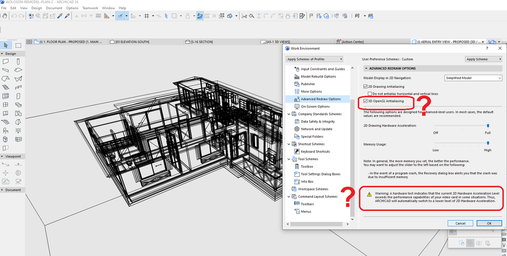

what has happened is as follows:
1) file was working "ok", then from time to time an "open gl" error happens where I can no longer rotate and spin the model using the Open GL engine?
2) the file crashes consitently to the point where I have to hit the entire PC reboot button.
3) I've been told my 'libraries' if properly clean out to the point where I do not get over 4600 warnings would help in file stability.
How can I fix this Open GL error crashing issue? I'm will to pay whatever it takes to get this F%$ file fixed.

If there are unexpected errors or crashes or hangs then it is possible there is something wrong with the computer hardware like faulty memory or some other component. This is why it would be a good idea to check if these same issues occur on another machine as well. It they do, it is probably the file. If they don't it is probably your machine (hardware or software).
For example, did your friend encounter the same weird issues you did? If he did not on his machine, it may be your hardware that is at fault here.

well, since my friend who's a master Archicad guru type fellow, cleaned out my libraries as best he could, I still have 15 warnings but better than 4600+ warnings, the file has become much faster, much more stable and, knock on wood, has not gone sour.............so thanks Ransom for cleaning up the libraries for me. Money well spent.
