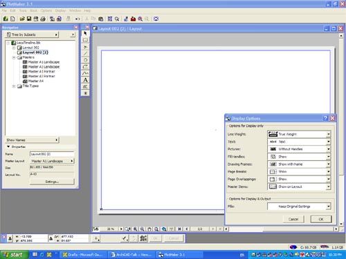

tsturm
Lazlo
I was hoping that the page breaks would be visible on the layout page where you place the drawings and other such things.
I know that these page breaks can be seen in the Plotmaker as Options. I would like to see some feed back before I get all the way to a Print box and another Options box to see the effect of not having the correct match of Page Size to Layout size.
You are correct that this can all be done with the current release of PM. Do you recall though what happened in PM2 when a different page was chosen than the layout? You got this grid of pages or a page which was way larger than the current layout sheet could accommodate.
I wish I had a copy of PM2 installed so that I could get a screen capture to show you better of what I mean. In fact, there was an option in the display settings to shut this On and Off. Like the one in PM3 attached below.
The thing is. Right now, if the pages are bigger or smaller than the Layout, you do not see the breaks, even if the Display Settings are set to do so.
Could this be only a MAC thing?

tsturm, I believe the problem is that you have changed the paper size before uncheck "set layout size equal to usable print area". By doing that, Plotmaker automatically alters the layout size to suit the paper size. You should reverse the process!
Please refer to the image attched: if X1>X2 or Y1>Y2 (assuming you've turn on "show page break"), you will see the page break!
Hope this help.

The "problem" now is that you can set paper size for each Master Layout, and you can set paper size in the Print Dialog.
Previously - since there was only one Layout - whatever change you made in Print Settings to the Paper Size was immediately visible on the Layout.
I think what tsturm (Terrence, right?) misses is that now we do not have this feedback. We see the Page Breaks set in the Master Layout Settings Dialog, but do not see the Page breaks based on the current printer set in Print Setup. This would require another set of page breaks to appear on the Layout.
This could be a wish (maybe even possible to set in Display Option whether we want it visible or not).
