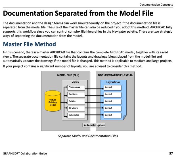

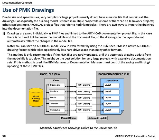

Karl Ottenstein
Archicad used to be delivered with a PDF manual called the "Collaboration Guide" in the Archicad xx > Documentation folder.  As far as I can tell, the last time this guide was published and delivered was with Archicad 21.  The Archicad 20 version (2016) is the only one I found via Google:
http://helpcenter.graphisoft.com/wp-content/uploads/2016/06/Collaboration-Guide-for-ARCHICAD-20.pdf
There was also a more recent document on either the Graphisoft Learn portal or the SSA subscriber content portal that described this same process in detail.  I can't find either of those at the moment.
A couple of screenshots of the first 2 pages of the PMK part of the Collaboration Guide:
