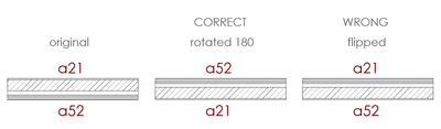

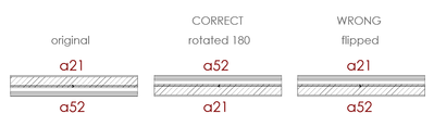

Problem with the side of labels of finishes when wall is flipped
Correct:
Rotation works properly.
Wrong:
The labels doen't flip with the element
With mirror, happens the same.

I don't think there is a problem.
Labels are associated to an element and will be in the position you place them.
All good so far.
As you rotate or move the element, the labels will rotate or move with the element.
It is just the association (anchor) point of the label that is moving with the wall.
Whether the label actually rotates to the same angle as the wall or not is dependent on the label settings.
But if you stretch the wall length, the label will not move.
Likewise if you flip the wall or make the wall thinner (change the composite), the labels will not move (they should update to reflect the property they are labelling).
Any edit to the geometry of the wall will not alter the anchor point of the label.

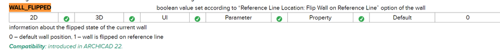

As Barry said, the label anchor point won't move when you flip or rotate a wall.
To achieve what you want you would need to adjust you GDL code in the label to recognise when you have mirrored the reference line and draw the label accordingly.

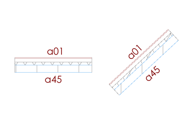

It's a problem for me because I want to annotate the finishes of a hundreds of walls by once and many walls has the label in the wrong side.
I can rotate 180 a wall in the centre, the anchor points has doesn't changed and the labels flipped correctly.
I don't see the point of the default behaviour of the label is not according to the flipping feature.

The GDL path will be a tricky one even for an experienced scripter.
Sure you will be able to recognise if the wall is flipped or not.
But I am not sure if you would successfully be able to tell the label to use a different anchor point.
Not only would you have to move the anchor by the wall thickness, you would also have to swap from top justified to bottom justified, or bottom to top (assuming they are the justifications you have used).
But you can still place the label on any side of the wall and it will give you the same surface, so i don't think you will win the GDL battle.
I could be wrong though.

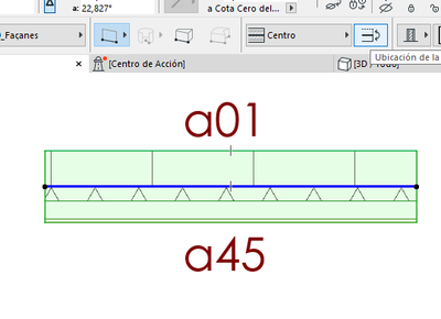

There ir a way to change the direction of a wall?

You can not select a flipped wall with find & select.
The command Scott mentioned is a GDL command but I doubt it will help.

You can invert the direction of a wall, command is in the edit menu somewhere ( I don’t have Archicad open at the moment so can’t say exactly where).
But I don’t think it will help you.
Inverting the direction of the wall helped, the labels flipped and placed properly, still it's a manual action without the find/select option.
