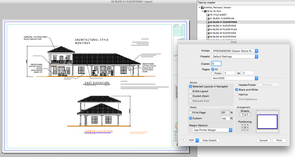

Since upgrading to AC 18 the publishing to PDF function produces empty files. Anyone with a solution for this? I have attached a screenshot for ease of reference.

I finally figured out a solid work around, try this. Bring up Navigator, create a layout, now select and open the layout you want to print. Use the FILE/PRINT command on the main menu. Then toggle the PDF (lower left of Print window) to Mail PDF, Save PDF, whatever output option you want. This technique still won't allow you to select multiple layouts to reside within a single PDF file. If you try that you will get a zero file. As long as I can generate single PDF files I am back in business without caving in and buying the upgrade just so that I can output a PDF file.

Burginger wrote:
Found that selecting the layouts in Navigator and printing from there, selecting the PDF option. It worked great to give me a single file, 15 sheet pdf. However, as far as I know there is no way when you do that to select the sheet size and retain the proper output scale. In other words it scaled it to fit on a 8.5" x 11" -- good enough for my clients laptop but not sure how the repro house can correctly print the 30" x42" sheets.
Before Print... command, go to Page Setup..., set Format For: Any Printer, Paper Size: Manage Custom Sizes and create a page size to match your output. Set the Non-Printable Area: User Defined, and all the margins to zero.

I finally figured out a solid work around, try this. Bring up Navigator, create a layout, now select and open the layout you want to print. Use the FILE/PRINT command on the main menu. Then toggle the PDF (lower left of Print window) to Mail PDF, Save PDF, whatever output option you want. This technique still won't allow you to select multiple layouts to reside within a single PDF file. If you try that you will get a zero file. As long as I can generate single PDF files I am back in business without caving in and buying the upgrade just so that I can output a PDF file. I will edit and post this in the original post so that anyone will quickly find it.
Yes that works Burginger!
