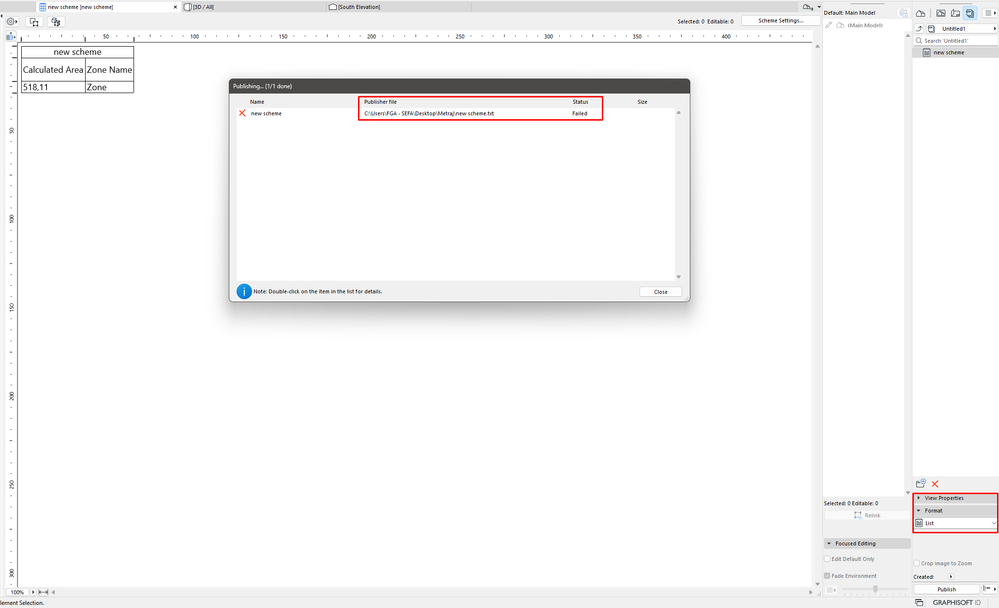

I get this error when I try to publish a list as .txt in Archicad. When I check the file directory, I see that it is published as .txt, but I get a message that it failed.
I have tried saving to a different file directory and I am sure there are no other .txt files in the background.
Operating system used: Windows Build 5003
2024-06-28 11:45 AM
I just tried and it worked for me.
Double click on the failed item and see if that gives you any more clues.
Maybe try publishing to to the root C-drive - so there are no dashes in the file path.
2024-06-28 12:49 PM
Check to make sure you don’t have any fields in the schedule that are referencing properties that no longer exists.
I’ve had the same thing happen.
