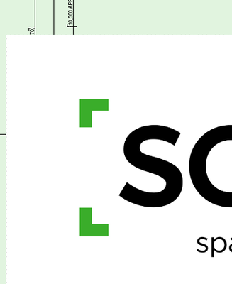

If I bring a logo in using the 'drawing' tool (the logo is just a JPG file with a white background) and I bring to the front display order, it will cover all that is behind it.

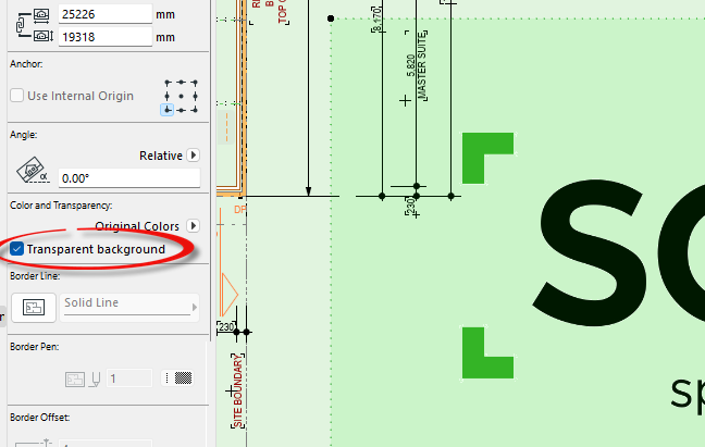

But if I now set that 'drawing' to have a transparent background, the white disappears.
This doesn't matter if I do this in the plan window or on a layout page.
