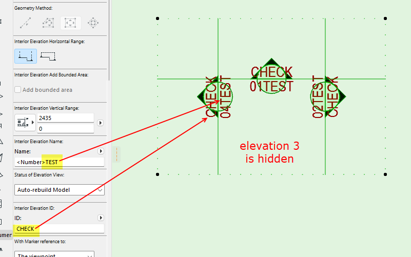

‎2024-04-20 09:42 AM - edited ‎2024-04-20 09:44 AM
I am using Windows.
Even adding orientation autotext works.
It is not a teamwork thing is it?
Is there another MAC user that could please test?

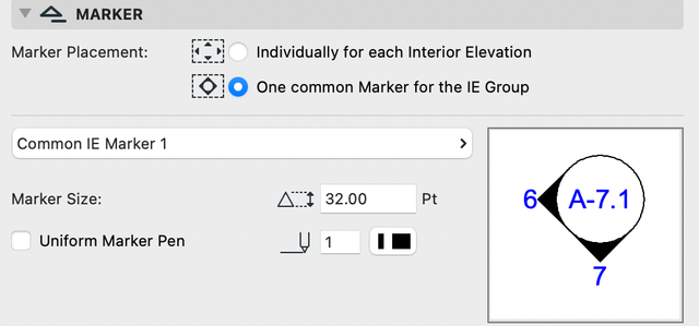

‎2024-04-22
05:39 PM
- last edited on
‎2024-05-02
06:40 AM
by
those are with the individual elevations. If the elevations are grouped into a single marker, you can not edit name or ID until you restore the missing/removed elevations. For example, a marker like this, can not be renamed: 

Works fine for me whether individual or common marker.
I just checked in 26 & 27.
Doesn't matter if I make the changes in the info box or the settings dialogue.
I wonder what else the difference could be other than MAC/Windows.
