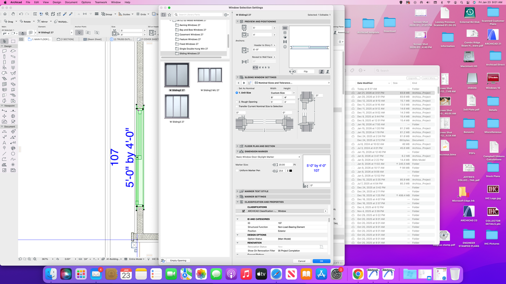

When you open Window Selection settings, under Renovation, the Renovation status is not highlighted and you can't change. This affects the window schedule and you can't change it from new to existing or get it to show up on the window schedule. How can I fix this?
Friday
The wall renovation status is not new?
Friday
On mine, you can't change it. It's not highlighted
Friday
if the wall is on the NEW reno status, the window will always have that option grayed out.
archicad won't let you put an existing or demo'd door or window in a new wall.
That is my guess, as to the issue
Friday
All the walls are new. It's just that the window renovation status is greyed out
2 hours ago
In a 'new' wall, you can only have a 'new' window.
If the wall is 'existing' then you should be able to change the window reno status.
