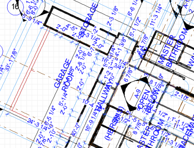

When I change scale from 1/4" to 1/16" the dimensions, text, and the markers read big. How do I make them read at the proper size? I have checked previous postings but could not seem to find the response I am looking for. Thanks.

The units for Dimension Text are paper-based so they change when you change the scale.
What you can do is you can place the View as a Drawing on a Layout, and then you can resize that Drawing on the Layouts, and it will then resize the text as well.

If your text point size is correct (6.5 pts as a minimum) then Lazlo's answer will "fix" your problem but when you print then your texts will be 1/4 the size which will make them unreadable. This is not the correct procedure for architectural drawings.
The correct way is to have 2 dimension and text layers sets one for 1/16" and 1/4" and you always dimension the smallest scale drawing first.

Am I correct to conclude then that elevation and section markers are not scale sensitive and have to be manually increased or enlarged based on the drawing scale?
I think so.
In the Marker panel of the Section/Elevation Settings Dialog you define the Marker Head size in millimeters so you are specifying paper size, not model size.
