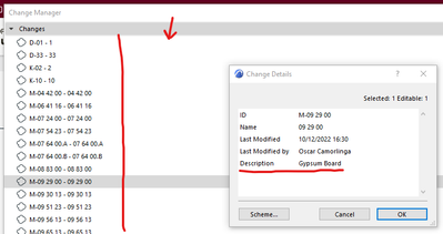

Hello, I feel there is no real way to do this but just in case I'm missing something:
Is there a way to show a custom field from the Change Scheme under Changes in the Change Manager? For example I have a "Description" field in my Change Scheme, is there any way to show that information in the Change Manager?
Thanks!

No, it is not possible to do that in the Change Manager.
However, in Project Indexes, one of the options is "Change List". If you set it up properly, you will be able to list your custom Change Scheme parameters.

Yes it shows up in the Project Index as an option. It would be helpful in our specific situation to be able to see custom Change Scheme parameters in the Change Manager directly, in order to select the correct change when placing a marker, but hopefully this gets introduced in future versions. Thanks!

If you would like to have it implemented you should make a wish for it so it can be submitted to Graphisoft for consideration.
If you do make a wish, please post its link in this thread.
