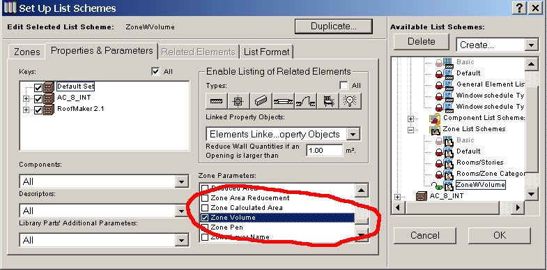

Speaking of zones. Does anyone knows how to get zone volume in listings or at least as feedback.
You have to edit the calc set to include it. It is in the parameter list.

Thanks Djordje,
I'll explore more Setup List Schemes. I need grouped volume values. It is easy in plain text format, but it is harder when you have to change existing graphic listings.

TRIBU wrote:
Thanks Djordje,
Forget the graphics, use the text and open it in Excel for further usage.
If the set is changed, after saving and reopening PLN all the changes are lost, and I get 2 error messages.
Am I missing something or it's just a bug .
