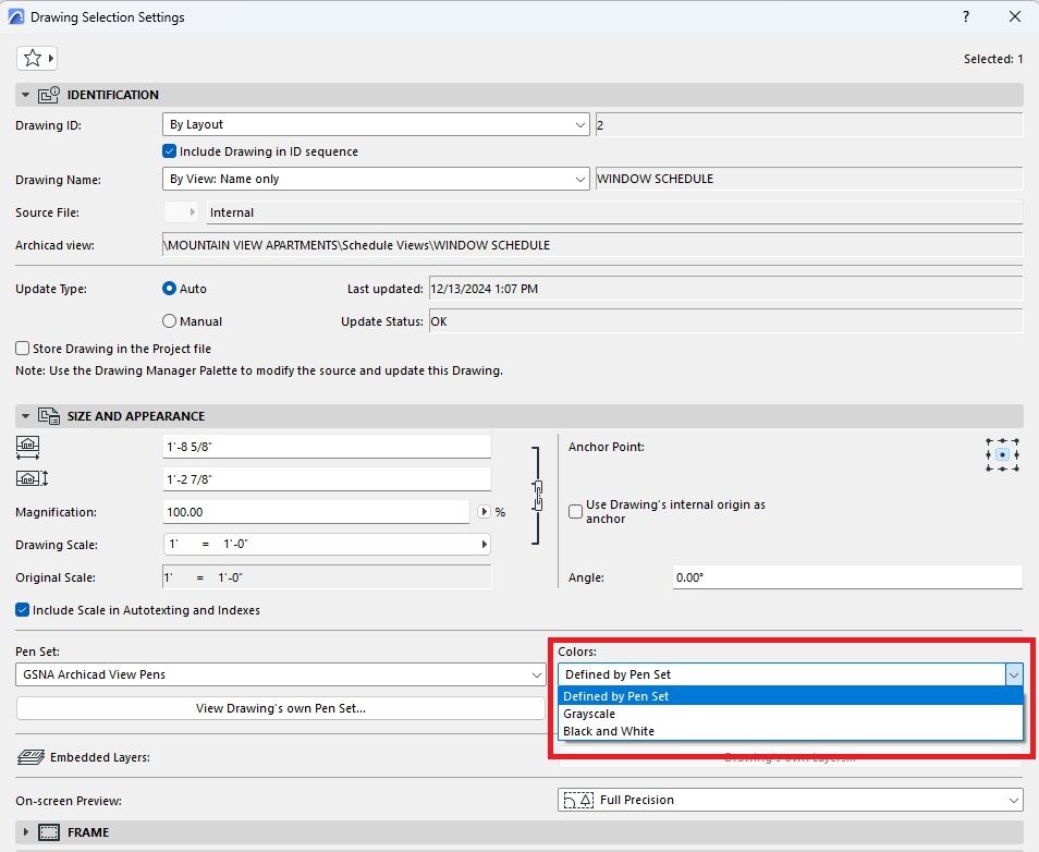

When you place the view in a layout make sure that your Drawing Selection Settings/Size and Apperance/Colors is set to Defined by Pen Set.  You might have it set to Grayscale.

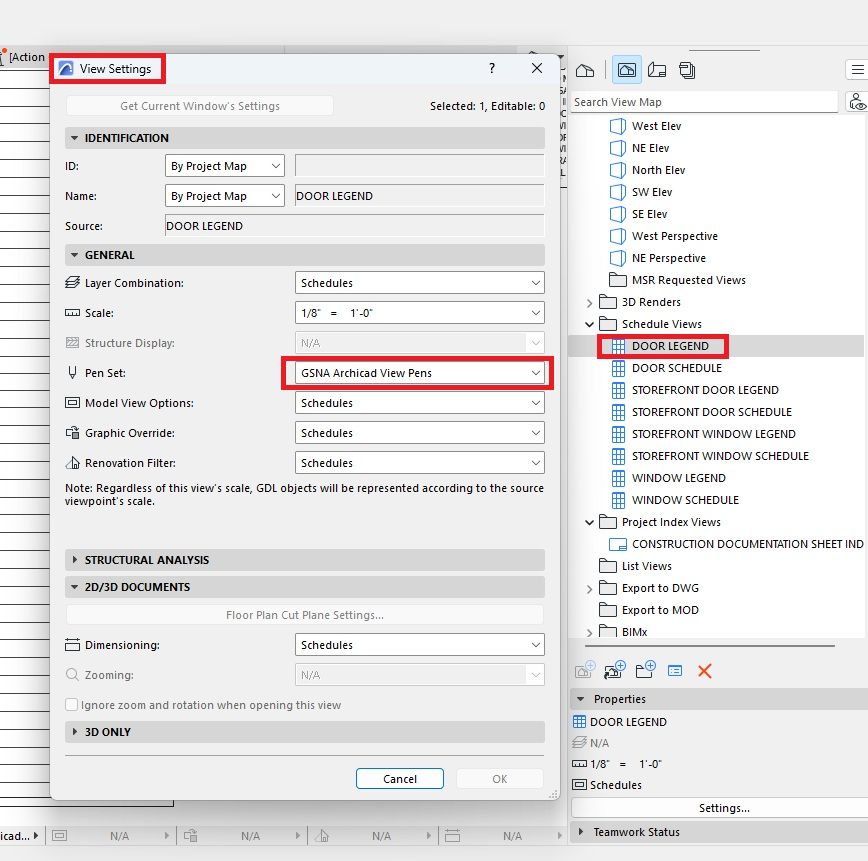

Check your view settings for the schedule/table and make sure that the Pen Set is set to the one you need.  It seems to me that you have a pen set for the plan view and a different pen set saved for the schedule/table view.

Raul, now that you've looked at the view settings for the index/table and verified that the Pen Set was set to the correct pen set you want, I want you now to look in two more locations for similar settings.
I want you to open your Plan View View Settings and double check that it also has the same View Setting/Pen Set as the index/table you verified previously in the index/table.
Once you have confirmed that it also is reading the same view setting as you have in the index, I have one more location for you to look at...
Now go to the Layout Sheet and highlight the view on the sheet you want to check and select the Drawing Selection Settings.  I want you to look at the Pen Set: and verify that it also is the same Pen Set you're using in the other two views.  And also make sure that Colors: Defined by Pen Set.
Verify all of these settings and let me know your result.  If you need me to do a recording to show you, let me know.
