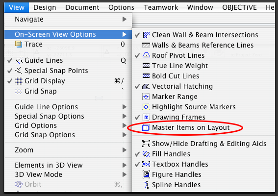

I've had some other glitches over the last week, so I reinstalled and updated last night.
This is only happening in one project (so far...).
All the master info is on the Archicad layer.
I checked pen #s to make sure they are visible regardless.
I tried making a new master layout from scratch. Still no information.
Does anyone have a clue what this could be?

Peter wrote:Peter check to see you have Master Items on Layout checked.
/.......Does anyone have a clue what this could be?

Peter wrote:
/.....All the master info is on the Archicad layer./......
Richard wrote:Says he's done so Richard, but it pays to check your other suggestions also.
/..I've learned (the hard way) to put everything in the Layout on the "ArchiCAD" layer.

Richard wrote:That sounds like a CadImage problem...
It has happened to me that I've ended up with multiple "ArchiCAD Layer" layers, and only one of them actually stays on permanently. So it never hurts to try turning everything on.

‎2007-12-08 10:24 AM
Peter wrote:I've had that problem too now and then. I think it relates to masters copied from other projects. It's been cured every time by "Show All Layers".
The title blocks on my master layouts are not showing up in the layouts.
And I don't have any Cadimage addon.
