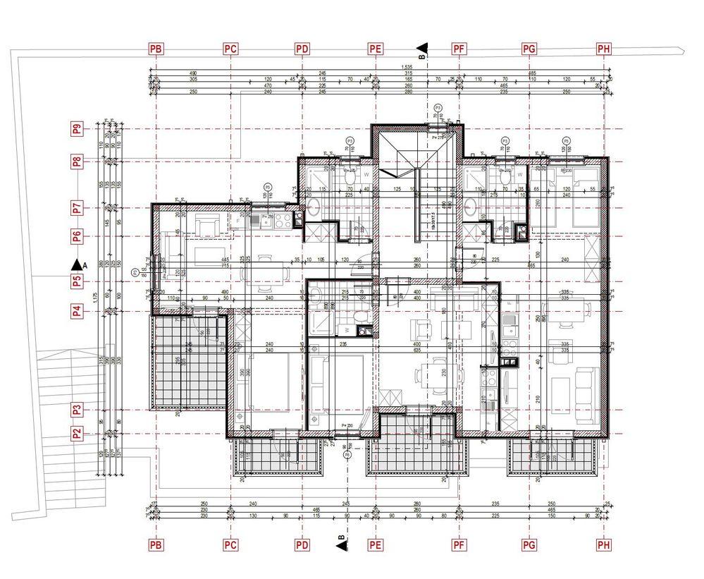

1. I finished model and all drawings of old existing house and put it all inside existing renovation filter in Project Map. Picture 1

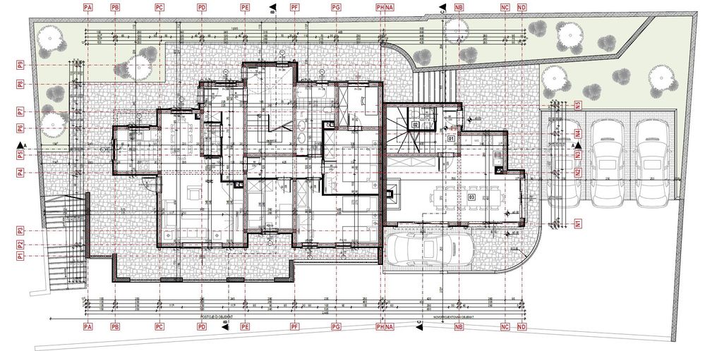

2. Next to old house I designed new house and put it all inside New construction renovation filter. Picture 2

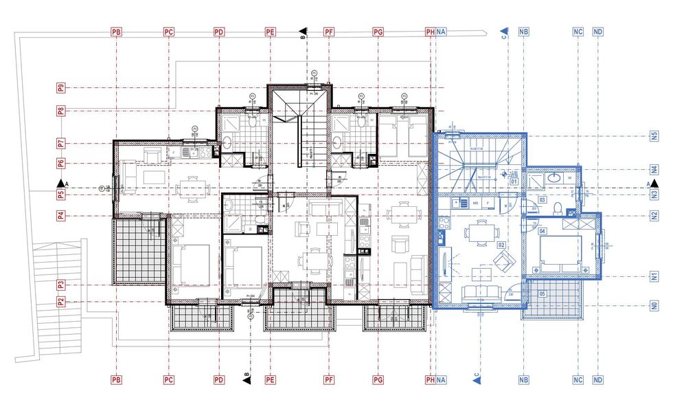

Is there a way that I use view map or whatever (but inside same AC file) and (because of law and regulation in our country) do this:
1. Save a view (or do something else) of existing house do dimensioning and floor plan detailing etc....and as that finished drawing put it on layout.
2. Turn on existing renovation filter + new construction than do dimensioning and floor plan detailing and as that finished put on layout.
Problem starts, when I place a view on view map and start changing some things that I need to do (dimensioning and detailing on new building part of design ) it shows on Plan view and automatically on existing building or it changes my model, than sections are not correct etc....Or when I on existing plan view or map view I do dimensioning on both existing and new construction...and when I turn off new construction dimensioning stays on new construction even if I turn off so it looks stupid.
Basically I want to finish my full house model (old + new) than  make a view:
1. Existing plan and do my work dimensioning and detailing and all separately not showing anything of my extra work on New plan
2. Existing +new and do my dimensioning and detailing but separate from 1st view above and what I draw i 2nd view doesn't show in 1st view.

I provided what I need to have as finished work in pictures.

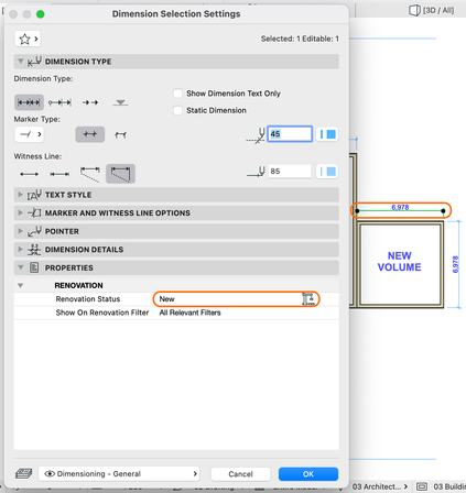

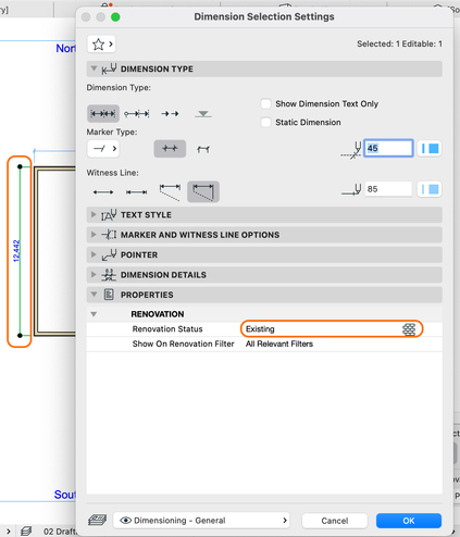

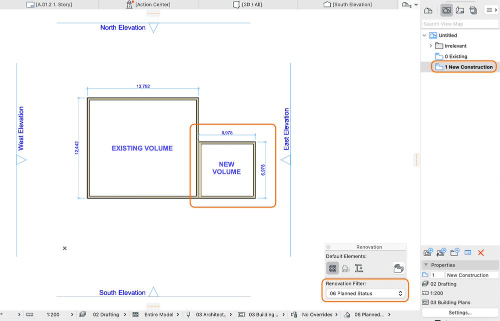

You can manage dimensions/annotation with the renovation palette itself (Window > Palettes > Renovation Palette). You can set the status of your dimension lines to "existing", for example, draw them and later do the same for "new" elements. When you save a view, assign the relevant renovation filter to it. Voilà, you have separate annotation for each stage.
You set the status of your annotation elements using these buttons on the pallete:
See how you can achieve the desired result in the following example (view map):
